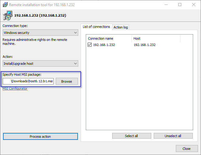

It would be better if the viewer could update hosts to 6.12 instead of 6.10.10. You're going to get less beta testing if you need to manually update it out of band on the host directly instead of remotely.
Actually, it is possible to update Hosts remotely via Viewer. In order to do this, please consider using the Advanced update method via the Remote Install Tool as described in this tutorial. You only need to download the latest Host .msi package, i.e. in this case, the 6.12.1.0 (Beta 1) version and then sel ect it within the Remote Install Tool window:

Actually, it is possible to update Hosts remotely via Viewer. In order to do this, please consider using the Advanced update method via the Remote Install Tool  as described in  this tutorial . You only need to download the latest Host .msi package, i.e. in this case, the  6.12.1.0 (Beta 1) version  and then sel ect it within the Remote Install Tool window:
Thanks, this seems to work? I hope there is some work done on the version status and current status in the Viewer. It's annoying when it appears or doesn't appear, or wrong when it appears... I upgraded several hosts to 6.12.1 and after reconnecting to them, they reflected that in the Viewer.  Hours later, I went to remotely edit the registry on a different host and the Viewer crashed (I submitted the error reports since it prompted and was easy) and needed to be End Tasked to close. But when I reopened the Viewer, all the hosts that previously showed 6.12.1 are back to showing 6.10.10 version or even 6.10.5. Why can't the Viewer monitor the status of the upgrade and so it knows when an upgrade is successful and therefore can immediately know the version, or the host does a callback with the version info? I complained about this in the past and thought there was a plan to improve on that in the future...
