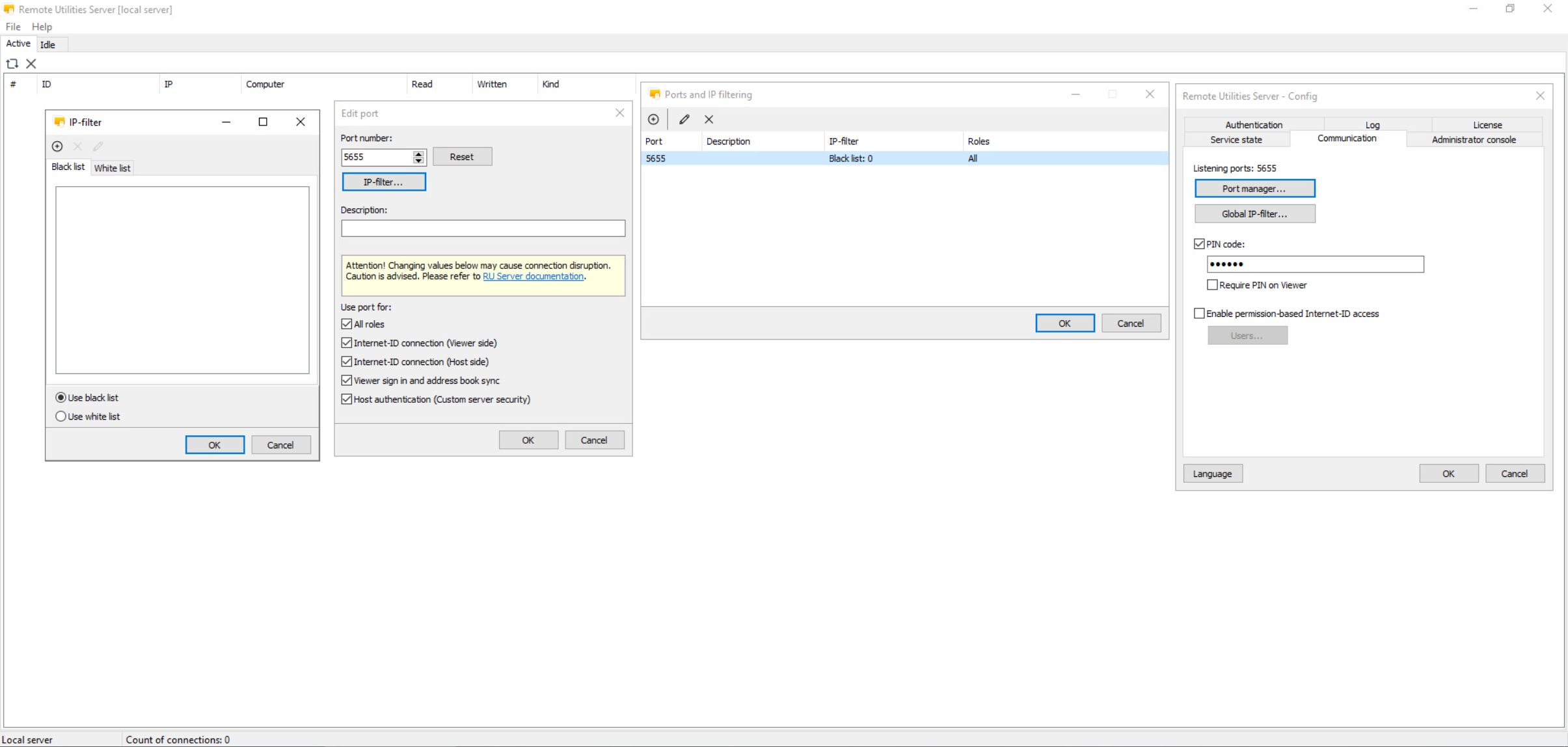

Could you please send us a screenshot of your Server's Port Manager window?
Thank you for your patience and apologies for the delay.

As requested. I've included all dialogs available, up to and including the edit port window. I also took the liberty of including the IP-filter window for completeness.Pauline wrote:
Hello Anthony,
Hello Anthony,
Could you please let me know if you’ve tried listing the IPv6 port values in the Port Manager window (in fields where you have the port 5655 on the screenshot)? This is where you typically set up a custom port for your RU Server. If you haven’t tried that yet, please try doing so and see if this helps.
Let us know if this works for you.

I'm sorry, I'm not sure what you mean? There is only a field for a port, not a address to listen on.
Do you think that IPv4 and IPv6 ports are somehow different?
It's not like IPv6 ports are with letters while IPv4 ports are with numbers...
Please do as originally stated and pass this on to someone who is familiar with networking.
