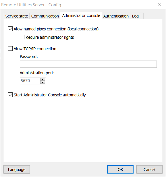

Support (Posts: 3125)
Mar 24, 2021 10:57:16 am EDT
Strictly speaking, our Host is also a "server" (as in the "client-server" architecture). It's only that we call it Host to distinguish from RU Server.
RU Server package consists of two parts - a client, which is the Admin Console and the server, which is the actual service running on the computer where RU Server is deployed.
Usually both parts are installed during RU Server installation. Then you can administer the service from the Admin Console - i.e. connect locally from 'client' to 'server' on the same machine. However, you can also connect from Admin Console installed on another computer. Before you do that you should configure access to the service in Configuration -> Administrator console tab ("allow TCP/IP connection"):
That said, for remote management of RU Server it is more practical to just install Host on the RU Server machine connect from the Viewer and then run the Admin Console on the server machine. That's at least how most users use it according to what we can see from the feedback.
