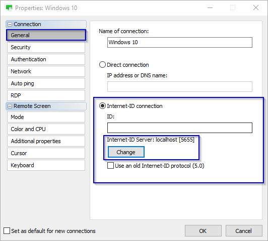

2) The custom server's address is specified in Viewer, in the Connection properties for this specific Host (as the Default connection properties dialog is rather a global setting that applies to all newly added connections, which might have been specified after this specific Host was added to your address book):
WIndows Version: All computers showing OFFLINE however are all still accessible. - 22 Jul 2020 06:03:54
