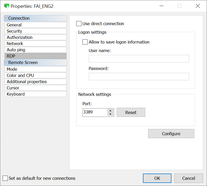

Could you please double-check if you have the logon credentials for your remote machine saved on the RDP tab in the Connection Properties window? If this is the case, then please try removing the saved credentials from there and see if it's possible to connect this way.
In addition, please clarify if you use RDP or RDP-over-ID connection mode?
Hi Polina,

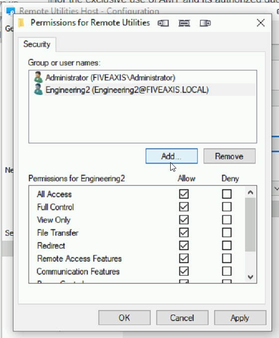

RDP-over-ID is what I'm using. The interesting thing is that I can access other machines, except this particular one. I do no t have credentials stored in neither the RDP tab or the RDP connection settings. See attached images.

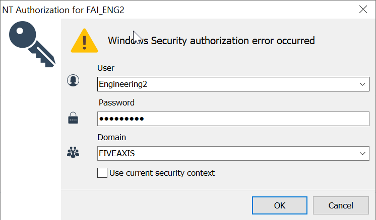

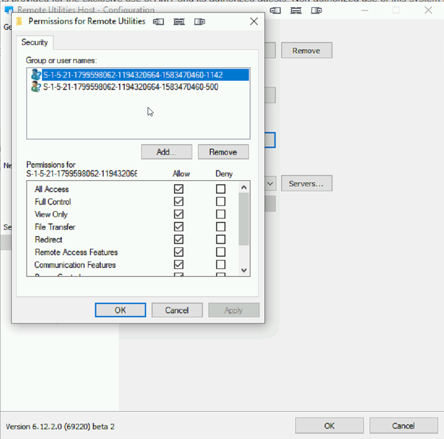

I am able to connect via Full Control and View Modes without issue. Attached are the images of the Modes and Other Tabs. I tried logging in with another Admin account on the Domain and got a new error about a relationship. Additionally, I removed and added back the authorization account and got nowhere. When I tried to review the accounts, they had been scrambled. Could this issue be related to the Beta version I am running on the viewer and the host? I don't see this issue on another PC I connect to via RDP, that PC is running the latest stable release instead. I've emailed the logfiles to the email above.

I've checked on the issue with our developers - unfortunately, it seems that the issue is caused by some system administration issues. Remote Utilities launches and utilizes the standard RDP protocol and only provides a transport tunnel for the connection, therefore, all of the access and permissions issues within the RDP connections should be resolved by your system administrator as it's, unfortunately, beyond our scope of technical support.
As for the access permissions when using RDP-over-ID, each user on each remote machine has a different SID, even for users with the same usernames. Unfortunately, most of the time a user's permissions cannot be configured out of the domain and then transferred to another machine. It's only possible for standard groups and for domain users (not for local ones), located within the domain.
