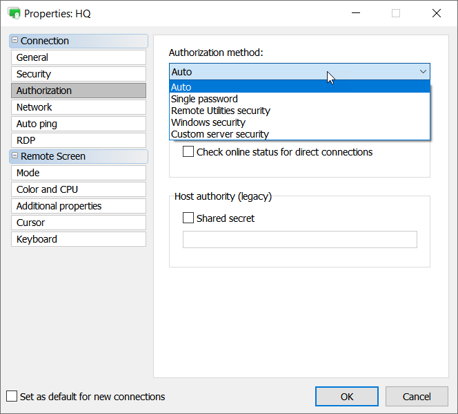

I already tried both :-) . It didn't make a difference. I think I had read on another post that "auto" chooses custom server security first if that protocol is enabled on the host. I tried a bunch of things to isolate the issue when I investigated it, and the only thing that I identified that was different about the setup is that the host in question connects to the RU server via the Internet, as opposed to the intranet. But, that doesn't mean that's the cause of the issue.

Yes, correct. We also explain that in our documentation, on this page (see the yellow-highlighted area).I think I had read on another post that "auto" chooses custom server security first if that protocol is enabled on the host.
