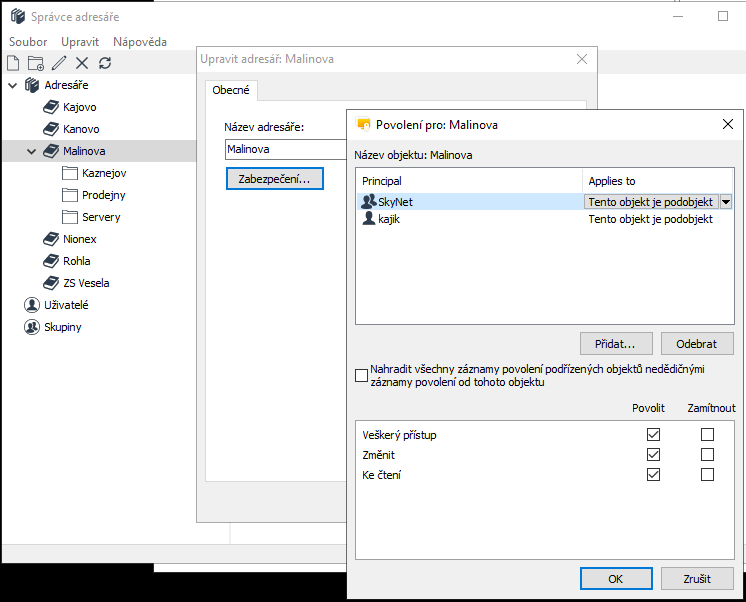

I found this thread trying to solve same problem. I set up own server - according to manual, firewall and port forwarding, everything works fine, auth, logons, it even gives me the list of address books I have permissions for when I login. But they all appear with exclamation mark and when I try to add a connection to the address book, it gives me the same error as Matt has described before.
So I tried suggested workaround, adding an user to one of the address books rights and voila, that one magicaly became online and avail for editations.
I'm uploading screen (czech version, sorry), the 'Malinova' directory has user 'kajik' added explicitly and works, others have only group 'SkyNet' which the user 'kajik' is member of. Other directories return error 'sync server is unavailable or offline', Malinova directory works flawlessly, changes sync in 2 seconds..
I'm staying tuned if anyone wants to solve this - or if I find the problem..

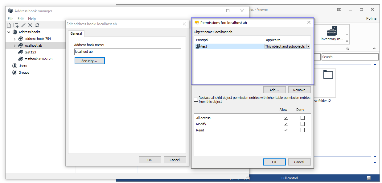

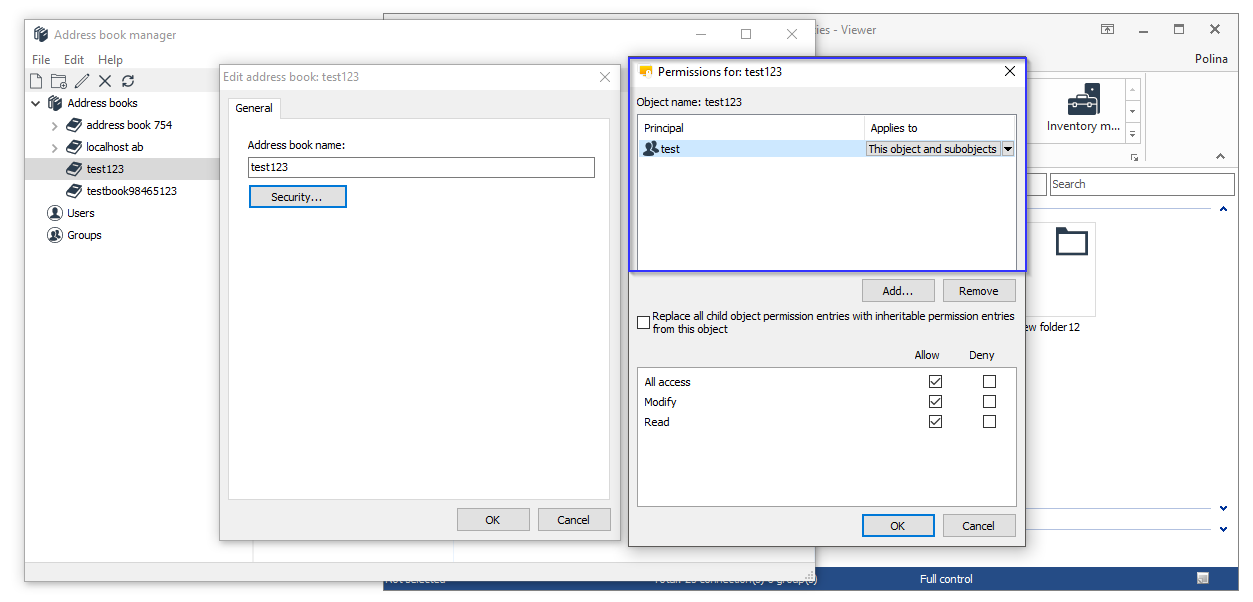

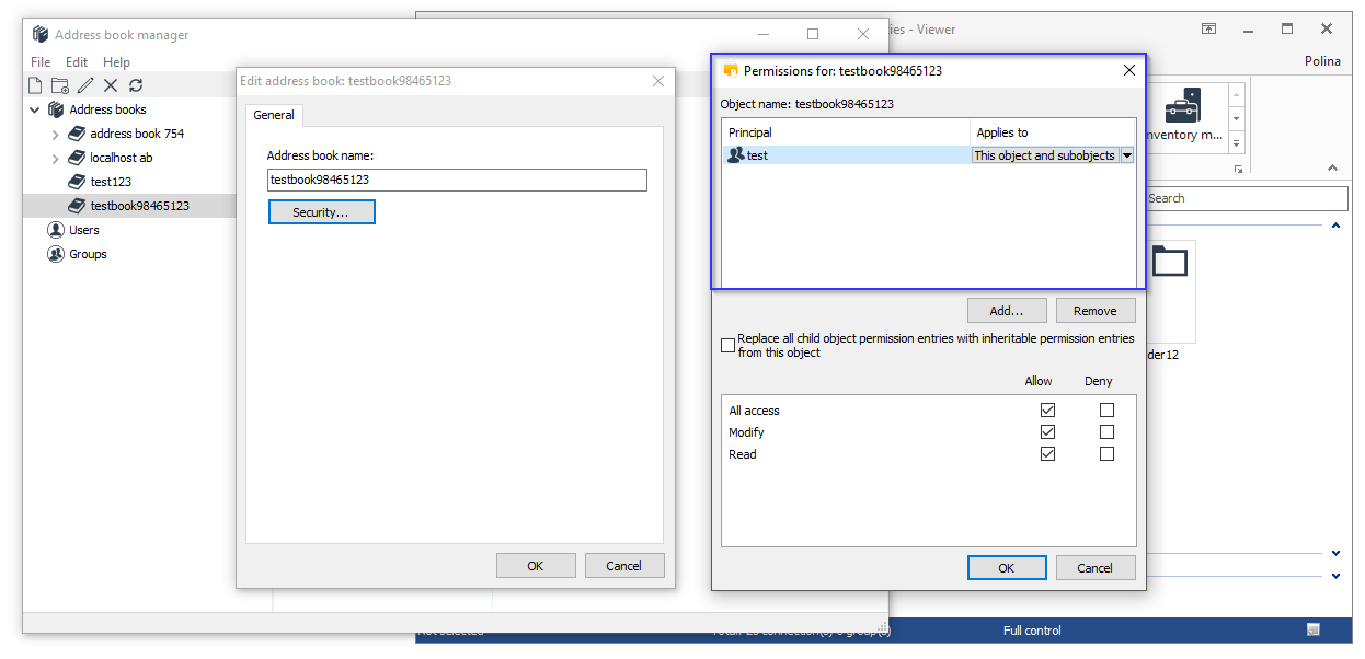

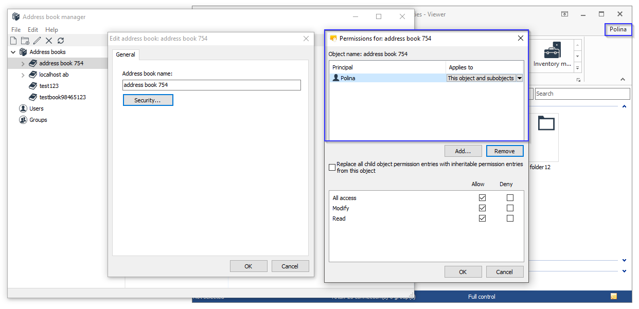

We have thoroughly tested this time again and still couldn't reproduce the issue. Multiple books synchronization works as expected with a group added as security principal just as with a single user. See the attached screenshots.
Please try resetting your Viewer configuration by closing the Viewer and deleting the file config_4.xml found in %appdata%\Remote Utilties Files\ folder. Don't worry, deleting this file won't affect your address books, it's just a file where Viewer keeps its settings/options.
Then start the Viewer again and see if the problem persists.
