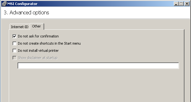

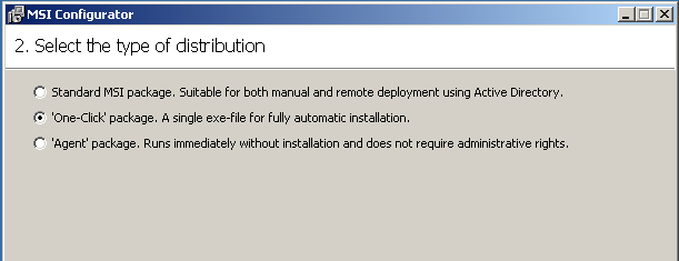

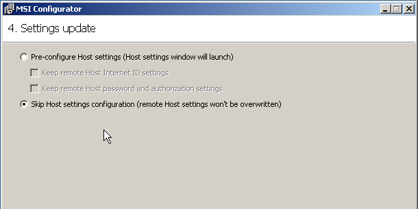

If a client already has RU host installed, can you allow 1-click install to completely install without asking the user to click "OK" at the end? They tend to blow themselves up because they're not paying attention and immediately click "CANCEL/NO" which of course causes us a LOT of grief.

Hi Michael,
In order to do that you need to build the one-click installer with the following options:
On step 2
https://www.remoteutilities.com/images/forum/topic489_1.png
On step 3
https://www.remoteutilities.com/images/forum/topic489_21.png
https://www.remoteutilities.com/images/forum/topic489_2.png
On step 4
https://www.remoteutilities.com/images/forum/topic489_3.png
This build will update the Host to the latest version, but the ID, password and other Host settings will remain the same. Also, no notifications to the user will be shown other than standard Windows message about whether the user wants to run such-and-such executable.

Michael Lewis,
User (Posts: 32)
Jun 09, 2015 1:12:19 pm EDT
Thanks - that worked exactly as I needed it to
