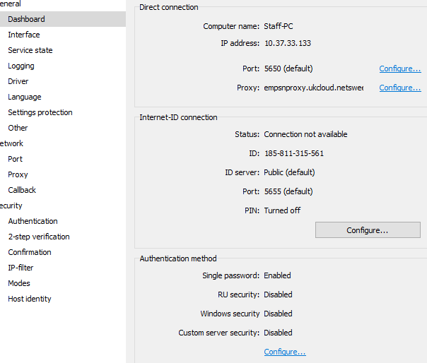

Remote Utilities suddenly stopped working  . Proxy configured but states connections not available.  Using latest version.  We have been using Remote Utilities for a long time with no problems

Many thanks for your quick responsel.  I can confirm that we are using the version 7.1.2.0 as I upgraded to this on the computers with host installed as they all suddenly lost connection to the internet ID at the end of December.  The PCs  still indicated no connection available whereas before they setup without any problems when I installed the proxy settings for the school  which have not changed. I have checked the firewall and ports which appear to be ok.  I use Remote Utilities to connect fr om home so no proxy needed in the viewer settings. I have also tried viewer in school wh ere I have installed the proxy on viewer. I initially thought it was problems with the proxy but installed  [censored] on one of the same computers at school as I have remote utilities on and that works fine through the same proxy. Our proxy setting is empsnproxy.unclouded.netsweeper.com with port 31479. I even contacted netsweeper to check all was ok. What I don’t understand is [censored] works through the proxy whereas Remote Utilities won’t although it did for over a year. I much prefer RU as it has great tools.
