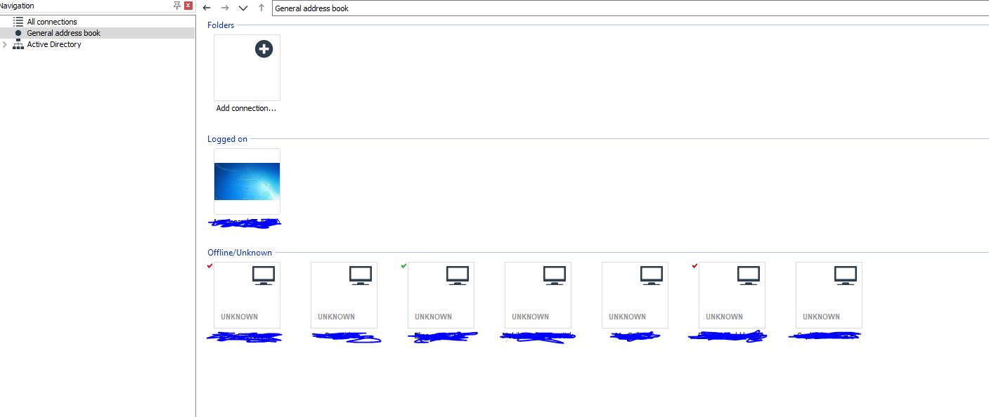

I have this problem too. I have a total of 6 computers. All six have the host program running and two of them have Viewer running (although I loaded viewer on all of them, they are not running)

I think I found it. I had under "All Connections" a General Address Book" with my 6 connections and also a "PrimaryList" with 5. When I delete the Primary List so that I only have the General Address Book, then the error message went away.
I was thinking the additional address books were subsets of the General but I guess they are additive.
Don
Don

That's correct. All connections from additional address books as well as from the AD tree also count against the license.I was thinking the additional address books were subsets of the General but I guess they are additive.
