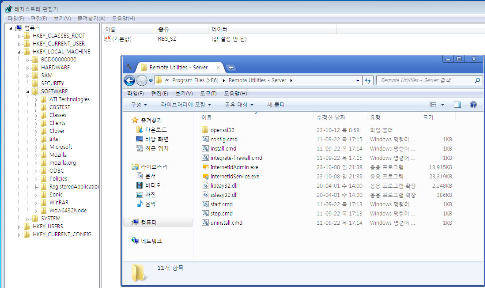

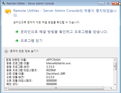

3.3.5.0 is OK but 3.5.5.0 is crashed
OS : Windows 7 Enterprise x64 ko-KR@Synology v7.2.1-69057
Test Method : Create VM -> Install Guest Tool&Reboot -> Install RU Server
Windows is completely Updated (~2020.01)
but v3.5.5.0 worked on Another VM for Test on VMWare Workstation 17

It hasn't any Antivirus or Windows Defender (Not included on Windows 7)
Even Reinstall Windows&RU Server same result
It seem New version RU Server not compatible with Synology VMM (or Old CPU)
All work well with VMWare but I want to use resource on my NAS

It crashed at run
No log created (I can't run any entry (Include Configuration (It mean I can't change log setting) )
Server v3.5.5.0 not work on 7 x64@vmm

All work well with v3.3.2.0
Upgrade 3.3.2.0 -> 3.3.5.0 = Crash
Remove 3.3.2.0 -> install 3.3.5.0 = Crash
Create new 7 x64 VM -> install 3.3.5.0 = Crash
Create new 8.1 x64 VM -> install 3.3.5.0 = Crash
(10 x64 not tested yet but maybe same result)
Remove 3.3.5.0 -> install 3.3.2.0 = All work well again

In this case, can you please export the Windows System Events logs following this guide. Please make sure that the logs include the time period of when you’ve experienced RU Server crashing. You can send the log file to support@remoteutilities.com.
dateno1, User (Posts: 14)
Oct 31, 2023 7:45:46 pm EDT
It hasn't any RU Server Log or Registy Keys
System Event Viewer Log was sent by mail (by @naver.com, not @chol.com)
All logs from New VM (not old VM)
