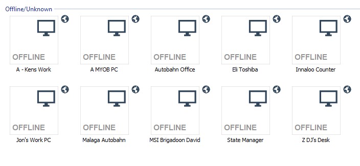

Asaf Tevet,
User (Posts: 19)
Oct 17, 2021 7:51:57 am EDT
Hi Conrad - thanks for the response. Unfortunately I've tried this already and it doesn't fix the issue. I started with a blank address book and added a connection that I know exists and should show as online but can not view it because it shows as offline in the viewer and also as grey on the agent I'm trying to connect to.
At this point none of the agents I have installed in my home are working - they're all showing as offline on the agent side.
All the ones I've checked so far are showing a relay redirect to the following IP address: 192.119.14.178
and an error code 96.
This wouldn't doesn't seem like something that is on the user end, this would be something on the internet server end if it is affecting multiple agents, and multiple RUT users.

Hi All,
Firstly I'm a newby to the community. I've been using Remote Utilities (and recommending it) for about 6 months or more with little trouble. My ISP is also iiNet AU and since Friday the 15th Oct I haven't been able to access any of my host PC's. I thought it may have been a gitch with RU Internet servers but have since been following this post and have done all the recommendations but to no avail - still can't connect. I have checked some of the Host PC's and they state 'Ready for connection'. Accessed one of my hosts with a 'Teamviewer' account and used the RU Viewer on that PC (also on iiNet ISP but different location) to remote access a couple of my know hosts and the RU Viewer worked fine. How bazzar - any help appreciated.
Asaf Tevet,
User (Posts: 19)
Oct 17, 2021 9:54:31 pm EDT
It definitely seems to be something related to the iiNet and TPG networks... TPG does own iiNet so I'm assuming they share various similar infrastructure and configurations.
So far RUT haven't provided any information to be able to wotk with the ISP to resolve this which is quite disappointing. I have a ticket logged and am hoping they'll give it ome priority.
Ken - are you able to connect your computer to a mobile phone and see if your clients are visible? that's my workaround right now... I'm looking for a permanent fix though.
Just remembered - Ken - what region are you in where it doesn't work? and what region did you connect to using your [censored] where it worked?
I'm in Sydney
I'm in Sydney
