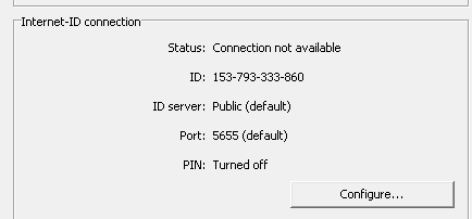

Our servers are running with 100% uptime recently and we haven't had any downtime or other issues with our servers - our servers are up and running as well as being constantly monitored. The grey Host icon (as well as the Offline and Connection not available statuses) means that the Host cannot connect to our Internet-ID servers - perhaps, our servers might be mistakenly blocked by some firewall/antivirus activity or the required ports are blocked or being used by some other software.
Before we can proceed with further troubleshooting please refer to this Internet-ID troubleshooting guide and see if any of the solutions listed there help to resolve the issue.
In addition, please double-check if the outbound TCP ports 5655 and 443 are not blocked on the Host machine. For more information on the ports used by Remote Utilities please see this page.

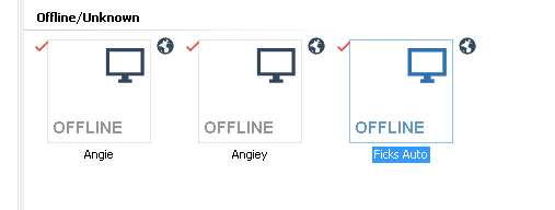

Hi guys - I'm having the same issues as above - I'm also in Australia although I don't know if this is part of the problem.
I have flushed my DNS cache and turned off my windows firewall - nothing so far has fixed the issue.
I have 2 computers that I run the viewer on (1 is a backup) so when my primary computer failed to show my clients as online I then went to my secondary computer which was working. The problem is that my address book was not up to date, so I copied y address book from my main computer onto my secondary as I have done countless times.
My secondary computer now ALSO refuses to show my clients as online or connect to any clients.
I've also tried to now revert the address book to the previous (working) version and still no luck on either computer.
This is definitely not something that is environment related ... help please!!!

Keith - my clients are mostly home based so generally NBN connections across the spectrum. My home connection is TPG NBN... I've now tried to change my DNS settings on my machine to point to the google server (8.8.8.8) but that didn't do anything :(
Keith - have you made any changes to your address book in the last couple of days? as I mentioned my backup computer seemed to be working fine until I updated the address book, then it stopped...

Keith - do you have an agent running on the computer you use the viewer on? I do... so this is even stranger...
As my primary PC was unusable, I brought up my secondary and could still see and connect to the primary computer before I updated my address book, even though the primary computer's agent was showing as grey on the primary and showing as online on my secondary.
Now that I've updated the address book on my secondary It no longer shows my primary as online and I can't connect to it either. My primary agent still shows as grey on the primary pc
Keith - are you using an internal RUT Server or the internet based server? I use the internet server
Edited:Asaf Tevet - Oct 16, 2021 11:26:07 pm EDT
