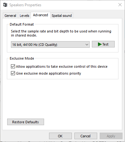

Regarding sound capture, we need more information.  Specifically, what exactly are you trying to capture? Is it something played back on the computer (like music) or you are trying to capture microphone input?
What's played on the PC. Doesn't matter the source, can be music app, video player, web browser (youtube)...it just doesn't capture the sound. This is what i have as audio devices, see attached
No sound capture No sound capture
Hi Petar,
We still couldn't reproduce the issue. Could you please send us the following screenshot (taken on the Host PC), see below:
No sound capture - 26 Oct 2018 02:26:15
There you go
No sound capture - 27 Oct 2018 12:18:47
Hello Petar,
Unfortunately, we couldn't reproduce the issue. The sound capture works exactly with the very same settings as on your Speaker properties screenshot.
