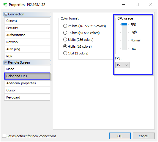

Hello John,
Please try adjusting the FPS manually. To do this, in the main Viewer window right-click on a remote connection and select Properties. Navigate to the Color and CPU section. Move the slider to the FPS mark first and then select a desired number in the drop-down list:

I checked with our developers on the issue. The multiple display handling also depends on the remote monitors' configuration. Could you please clarify if the remote monitors are rotated? Also, could you clarify the scheme of how the remote displays are located?
Also, try switching the CPU usage mode to Normal and setting the Color Format to 24 bits as it will reduce the CPU usage.
