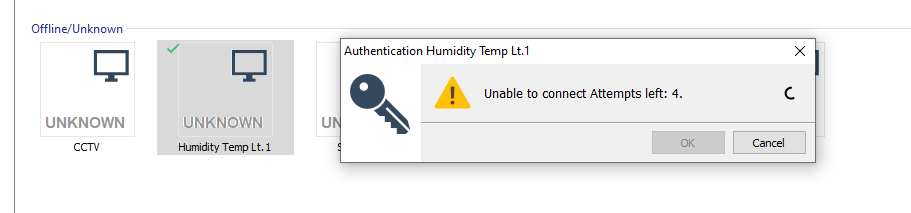

Hello dear Suport,
i have already added this port into my firewall.. but still cannot access.. can you give me other port used for remote
thank you..

Hello Sir,
im Connecting via self hosted / not connect to internet

hello there..
im sorry for miss information,
my computer use software that redirect connection to internet
when im using another pc to use remote utilities software its working so well...
thank you for your support and im sorry for my wrong

Hello Pauline
Yes, its works now.. thanks for your support...
