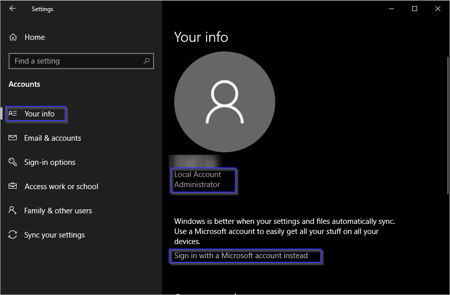

This is to inform you that we're currently considering that the issue might be occurring if there is an online Microsoft account associated with the Windows user on the Viewer machine instead of a local user account.
Could you please let us know if there is an online Microsoft account used on the Viewer machine where the issue occurs instead of a local account? This can be seen in Settings -> Accounts -> Your info:
If there is an online Microsoft account used, then could you please try switching it to a local account and see if this helps to resolve the issue? Here's a related guide on switching accounts on the Microsoft website.
