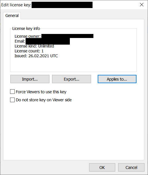

We have just tested this scenario (with portable Viewer) , everything seems to work well. See the attached screenshots.

Also, make sure that you explicitly allow the signed in user to use the key. In order to do that:
1. In the License deployment window select your key and click Edit.
2. In the Edit dialog click Applies to..
3. Select the user from the user list and make sure "All access / Allow" is enabled.
I assume that you might have missed that step. Currently, we are updating our documentation so more detailed instructions for this specific feature are comaing. Sorry for the inconvenience.
May I ask if you exactly followed the procedure provided in portable viewer update guide ?

The actual issue was that I did not assign the group allowed to receive the license key. After doing so, as per your instructions, I was offered to receive the key upon connection.
Case solved, thank you for your help!
