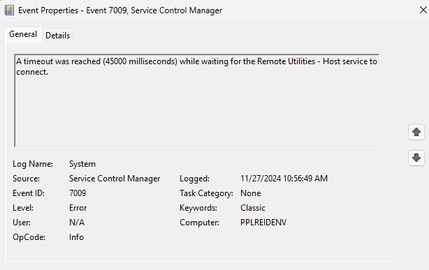

today, lost control of another three machines. in total, 10 machines.
this is from windows registry, two events
event #1
Log Name:      System
Source:        Service Control Manager
Date:          11/27/2024 10:56:49 AM
Event ID:      7009
Task Category: None
Level:         Error
Keywords:      Classic
User:          N/A
Computer:      PPLREIDENV
Description:
A timeout was reached (45000 milliseconds) while waiting for the Remote Utilities - Host service to connect.

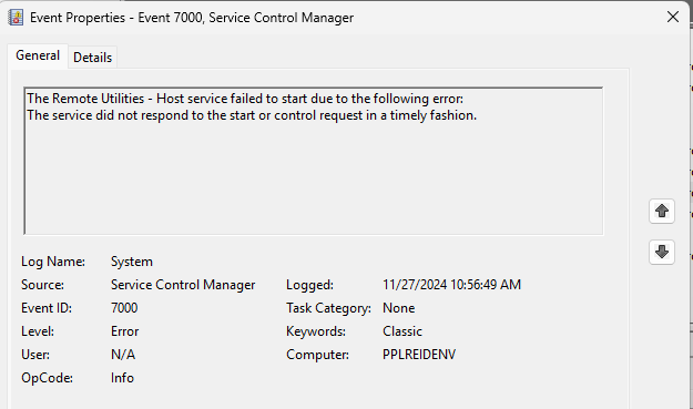

event #2
Log Name:      System
Event ID:      7000
Task Category: None
Level:         Error
Keywords:      Classic
User:          N/A
Description:
The Remote Utilities - Host service failed to start due to the following error:
The service did not respond to the start or control request in a timely fashion.

here are two screenshots of the event viewer.
