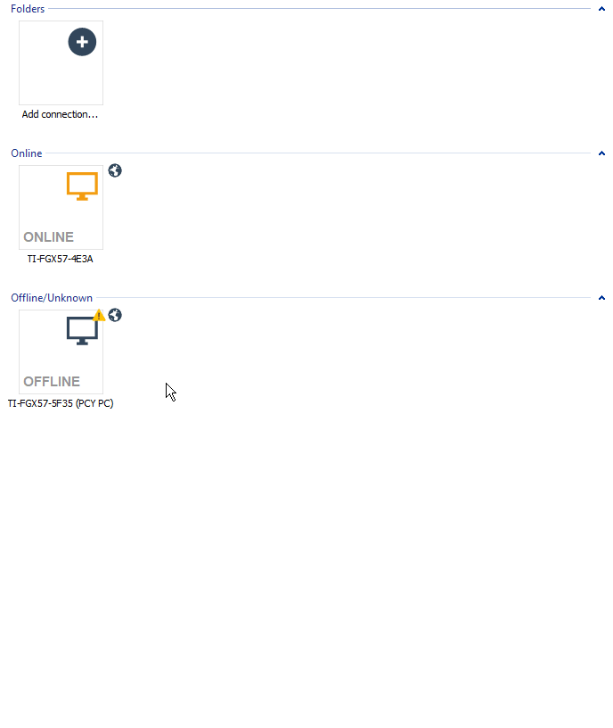

Using viewer 7.1.2.0, host 7.1.2.0 and ru-server 3.2.1.0
ru-server is hosted in a DC, viewer and host are on different business-grade connections
My problem is as follows:
  • Host shows as online
  • Attempt to connect (any action, doesn't matter)
  • Instantly get 'Unable to connect. Attempts left: ' dialog. Host now shows as offline
  • When dialog times out after 5 attempts, host will show as online again after a short interval
Here is a short screen-cap demonstrating the issue:
connecting to online host, host goes offline until you stop connecting - 10 Mar 2022 11:30:03
A temporary solution appears to be to restart the ru-server, but this doesn't always last very long. The issue varies in how frequently it presents.
I suspect something happens with the firewall in front of the ru-server that the ru-server/hosts don't recover from or the lack of IPv6 on the ru-server (most of the hosts are dual-stack with IPv6 connectivity but the ru-server is not currently configured with an IPv6 address)
This is quite problematic for us as not all operators have access to restart the ru-server (not to mention it is very frustrating when it does it multiple times in longer support sessions).
Any help greatly received.

Anthony Pidden, User (Posts: 12)
Mar 10, 2022 4:10:44 pm EST
Hey Pauline,
No AV on the server.
Viewer has been used on machines with Kaspersky AV and also a machine with just Windows Defender (i.e. nothing), same results.
Host machines both with KAV and without exhibit the problem as described.
I think that pretty much rules out AV.
Aside from the firewall appliance in front of the RU server, no software firewalls are used.
I'll see if I can get some logs from the ru-server and viewer.
