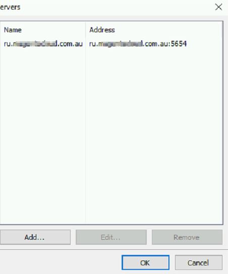

Bevan Howie,
User (Posts: 5)
May 19, 2020 4:37:57 pm EDT
Hi,
I had already tried both Auto and CSS as the auth method for the connection in the viewer - both give the same result.
Screen shots from the host below (with a little obfuscation). However as I can log into the server and load up the list of users / groups, doesn't this prove conclusively that the server address configured in the host is correct. The server is deliberately running on non-standard port 5654.

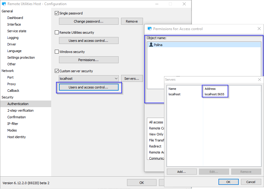

Hello Bevan,
Thank you for the provided screenshots.
It seems that we have managed to reproduce the issue. In order to further isolate the issue, could you please also try adding permissions in the Address Book manager for a user explicitly, i.e. not for a group but a separate user and see if you're able to connect to a remote Host using CSS this way?
