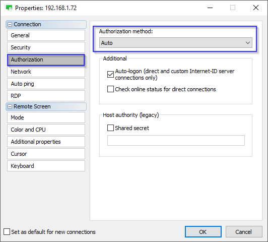

Hello Farid,
Could you please clarify what Authorization method is set in the connection properties?
![[Resolved] Error - this authorization method not enabled in remote host settings - 19 Aug 2019 10:35:34](/bitrix/components/bitrix/forum.interface/show_file.php?fid=5378)

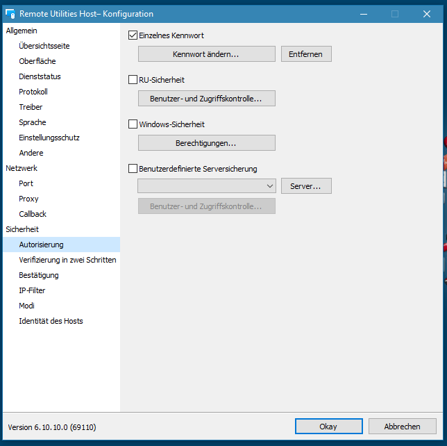

Also, could you please send us the screenshot of the Host settings, the Authorization tab?

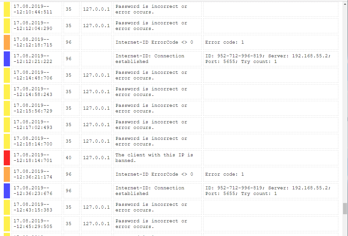

Farid Remtulla,
Aug 20, 2019 1:26:21 pm EDT
In the viewer, the authorization method is set to 'single password'. In the host the authorization method is set to 'single password'. I have uploaded screen shots of the viewer and host authorization windows.
Perhaps previously too many invalid log in attempts caused the IP to be banned as shown in the host logging file. However, I am now able to connect.

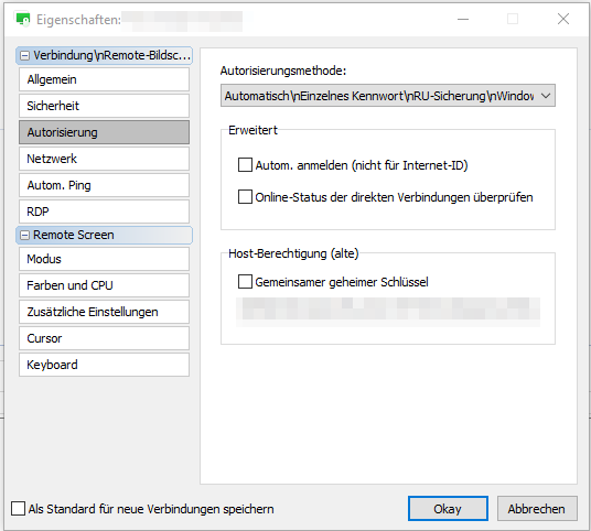

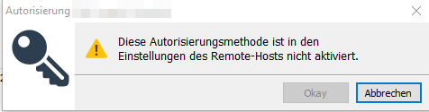

I'm struggling desperately to get a connection to a host. I even tried opening up a second one and tried multiple computers to start a remote session. I even tried it with a WinPE Stick from a VPN to exclude firewall and/or blacklisting issues. Doesn't matter if I use the default host or remote, trying to connect via ID, viewer says:
"Error - this authorization method not enabled in remote host settings"
I have set single password in the host and in the viewer (checked multiple times).
The host I add is shown as online in the connection manager.
Maybe you could help me out with this, since my mental health's slowly going down on this... %-)
Heres the Viewer's LOG:

Support (Posts: 3262)
Jan 07, 2020 3:20:57 pm EST
Hello Jay,
Could you please take a screenshot of your Host settings , the Authorization tab and post it here? Just to make sure that you have at least one authorization method enabled.

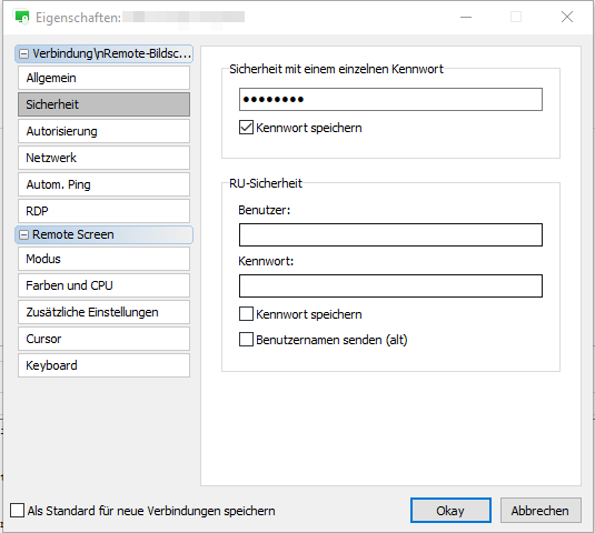

Could you tell exactly where in Viewer you set that?I have set single password in the host and in the viewer (checked multiple times).
