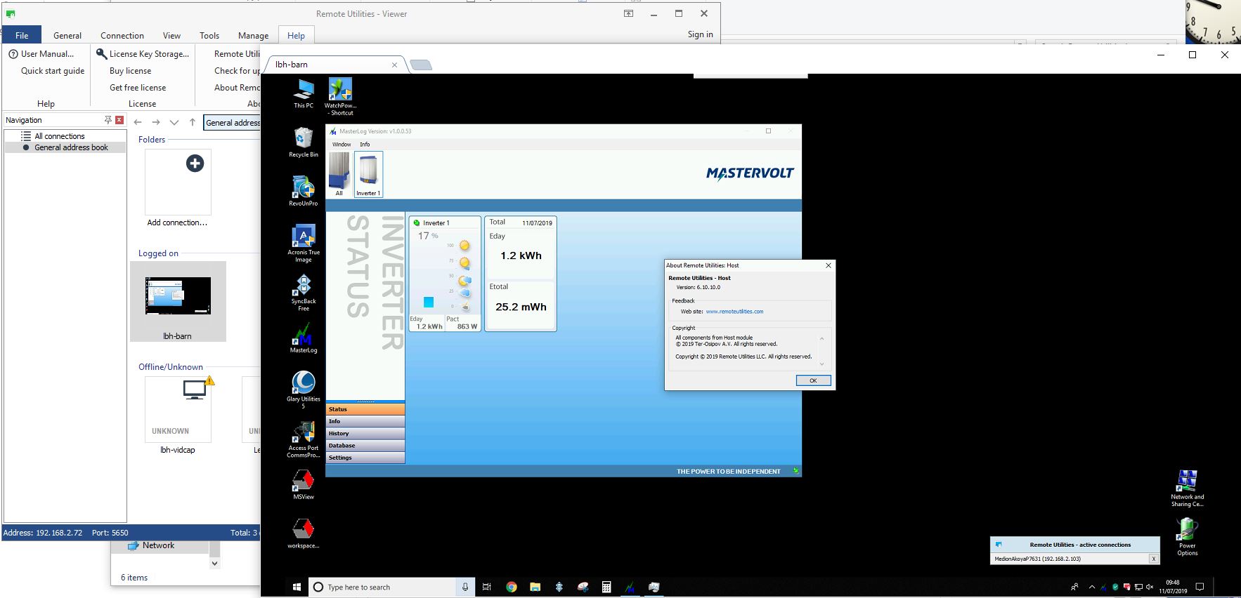

Still the same I'm afraid.

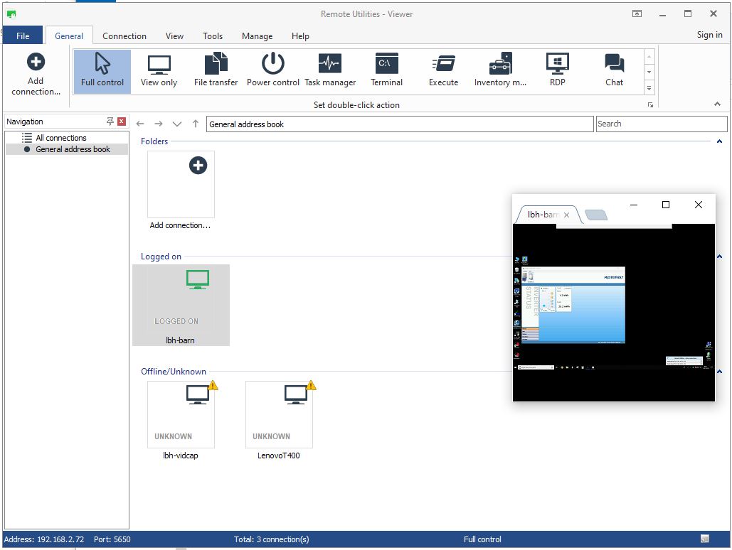

Run the viewer and double click on the host.
Remote desktop loads, then shrinks to minimum size.
Expand viewer window - as in 'After upgrade to 6.10.10.0(1)'
Close viewer, which closes host desktop.
Run viewer again and double click on the host.
Again Remote desktop loads, then shrinks to minimum size as in 'After upgrade to 6.10.10.0(2)'

This is to inform you that we managed to reproduce the issue. The fix will be implemented in the nearest update.
Meanwhile, here is a workaround that can help temporarily fix the problem:
1. In the main Viewer window please navigate to the Tools tab and select Options.
2. Navigate to the Remote screen section and select the Tabbed view checkbox as it's shown on the screenshot below.
Let us know if it worked. Thank you.
