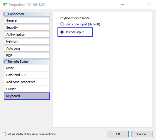

In addition, please try switching the keyboard input model to Unicode input in the Connection properties - Keyboard section and let us know if it solves the issue:
Enter, Shift, Ctrl and Alt keys not working on connections - 22 Nov 2019 04:00:20

I have tried setting the keyboard setting to Unicode. No difference
