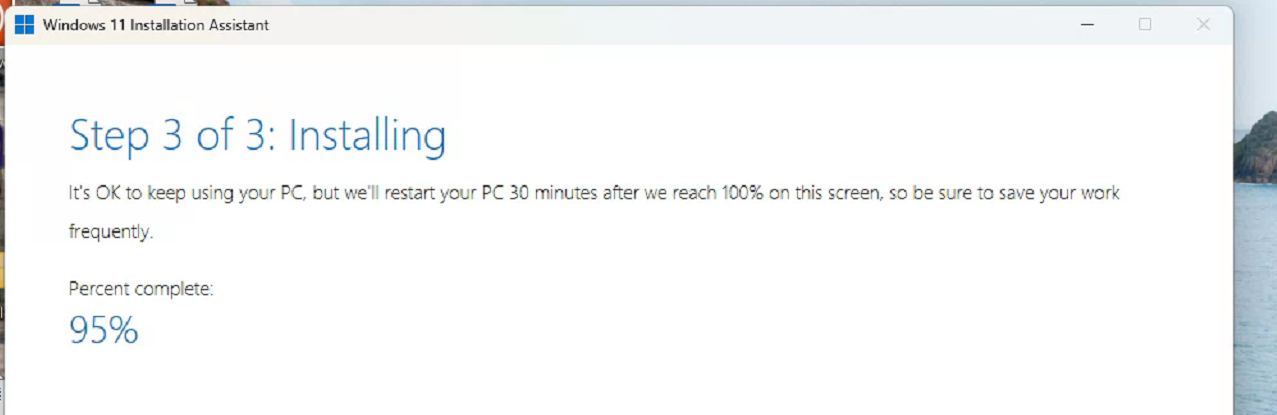

on the remote host:
1. I am NOT running windows update.
2. i am running "Windows 11 Installation Assistant" - Windows11InstallationAssistant.exe
https://www.microsoft.com/en-us/software-download/windows11
https://go.microsoft.com/fwlink/?linkid=2171764
please, see attached image
