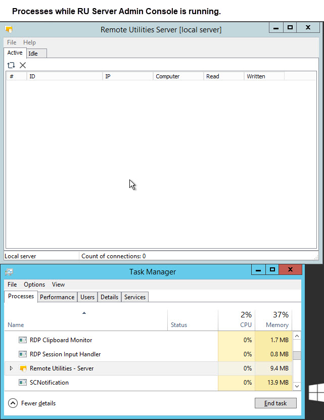

I am talked about the Admin Console program (Windows Start➝Remote Utilities Server➝Administration), not the service itself.
Hopefully, the following images of the processes and the Admin Console program will help clarify the information.
While the "Remote Utilities - Server Admin Console (32 bit)" is running, the Admin Console does not become visible if I attempt run Windows Start➝Remote Utilities Server➝Administration again.
Processes after: Ending the "Remote Utilities - Server Admin Console (32 bit)" task. Then restarting the Admin Console. Then selecting File -> Exit to close the Admin Console.
Now I am able to run Windows Start➝Remote Utilities Server➝Administration again and see the Admin Console window.
