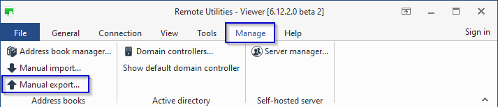

In case, if the password for this remote Host machine was already saved in your Viewer, then the issue might be occurring in case if the address book's file was somehow corrupted. Please try the following:
1. Locate the connections_4.xml file in the C:\Users\[Your_username]\AppData\Roaming\Remote Utilities Files\ folder and copy it to a different location. Alternatively, you can also manually export any address book by selecting the address book in the left pane, then clicking Manage ➝ Manual export on the Viewer's ribbon toolbar:
Service set to "auto", but won't ever auto-start on reboot - 02 Jul 2020 12:03:24
2. After exporting the address book, please erase the contents of the C:\Users\[Your_username]\AppData\Roaming\Remote Utilities Files\ folder.
3. Manually import the address book as described in this step-by-step guide and see if it helps to resolve the issue.
