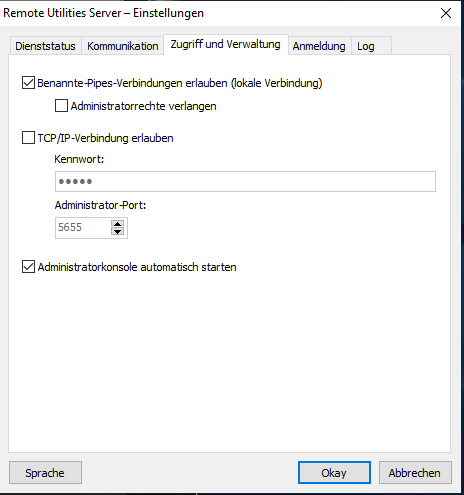

The connection via a DNS server has stopped working recently. No changes were made. The local connection works without problems. All ports are enabled in the firewall or on the router. However, suddenly no connection can be established from outside to the server.
This problem occurs regularly. Most of the time, simply restarting the service helps. This time the server is not accessible from outside, even after a new installation.
Image 1 Server : The local server can be reached.
Unfortunately it is no longer possible via the DNS server!
Image 2 and 3 : Settings from RU Server.
Thank you in advance for your response.

I found the problem. Several network cards are installed in the server. The RU server probably used a network card without a network or internet connection. So of course no connection could be made. Thanks anyway for your support!
