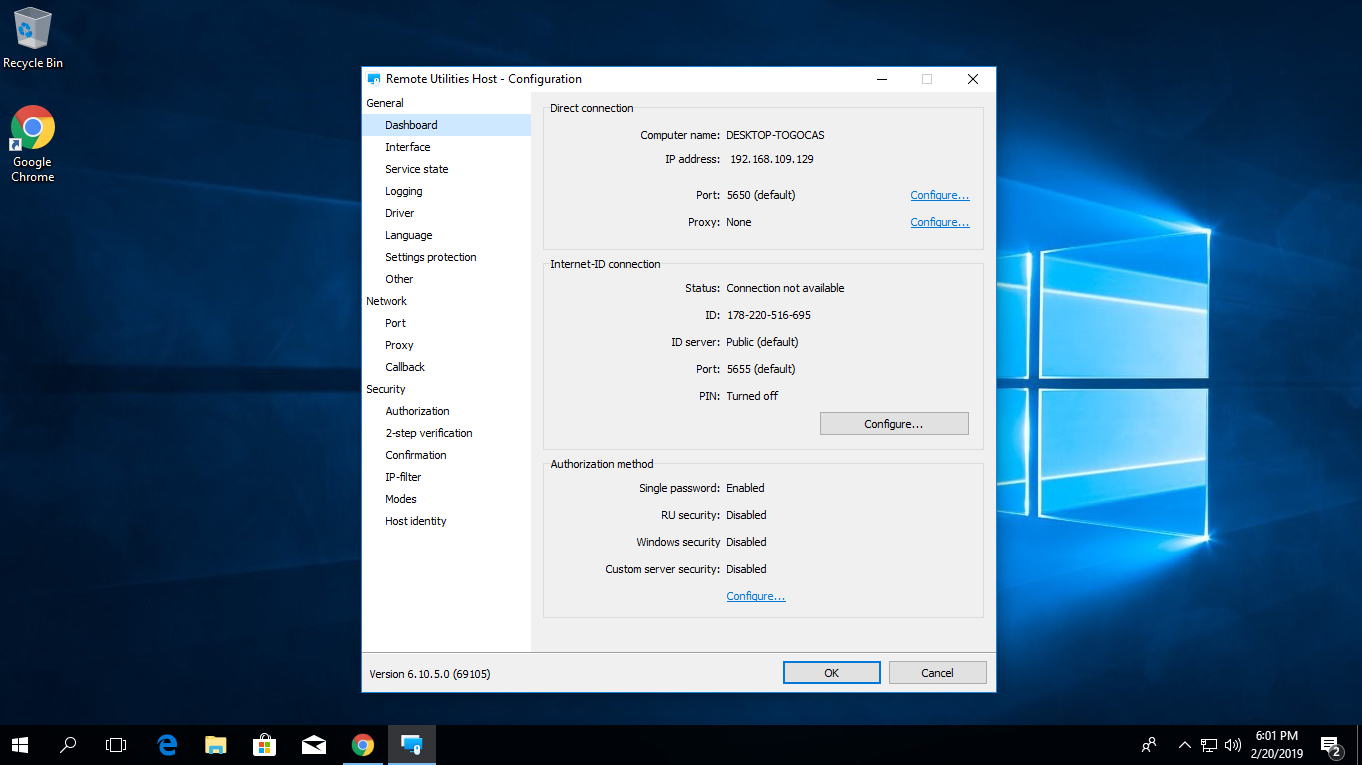

status: connection not available
I tried on 2 computers already to install host and on both i have status of connection: Connection not available. On second pc i don't have antivirus installed. I don't know what is the problem but i hope that you can help me to solve it.

Yes, still persist. I tried to turn off firewall and tried on different computers and host still have status: Not available. I also tried and old version of host and in logs i still see this error
23.02.2019---10:47:24:572 96 Internet-ID: Unable to connect to ID server. Address: id.remoteutilities.com; Port: 443; Connect timed out.(EIdConnectTimeout)
23.02.2019---10:47:29:573 96 Internet-ID ErrorCode <> 0 Error code: 1
