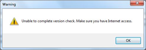

I have tried Simple Update from the same viewer, to two hosts on W7 and one on W11. In all three cases I get the same error message, screen shot attached.In addition, please let us know if you’re able to update remote Hosts via the Simple Update feature fr om the same Viewer?

On both these W7 machines, Host update using Simple Update does not work, with the same error message mentioned in my previous post.

In this case, could you please send us the latest Host installation logs for review? You can find the installation logs in the following folder: C:\ProgramData\Remote Utilities\install.log and send them to support@remoteutilities.com.On both these W7 machines, Host update using Simple Update does not work, with the same error message mentioned in my previous post.
