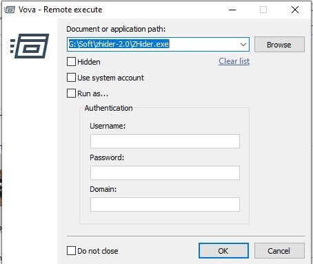

Hello!
Sorry, I don't speak English well.
Steps:
I open FileManager. I find the exe-file . Click F9. In the window I click "Execute". I open TaskManager. Click "Refresh". In TaskManager I search this programm.
Result:
The program is not running. In version 6 these programs were launched. Doesn't work in stealth mode either
Examples in attachment.
Windows version 10 Pro.
Steps:
Result:

Unfortunately, we couldn't reproduce the issue. Could you tell us what additional options in the Execute mode window you enable/use?

Hello.
Examples in attachment (launch in normal mode and in hidden mode).
Host.exe is installed on Windows 10 (x86). Viewer.exe is installed on Windows 10 (x64).
Program execute data is logged? If so where?
Maybe the required libraries are missing?
Edited:Igor Pomelov - Jun 11, 2021 4:55:27 am EDT
Hello Igor,
In addition, could you please let us know if the issue persists when you try running the programs with the Use system account checkbox enabled, or when you try using the Run as... feature?
In case if the issue persists even, then please feel free to send us the Host log files for examination. The Host logs can be located in the following folder: C:\Program Files (x86)\Remote Utilities - Host\Logs\. Please do not post the logs on the forum, you can send them to support@remoteutilities.com.

Hello. Sorry for waiting.
The logs were sent to the e-mail. First running without the Use system account checkbox, second running with the Use system account checkbox.
Running the program using the system account works.

I've examined the log file, but haven't noticed any error entries in it. Since running the program using the system account works, then it might mean that running this program simply requires some elevated privileges, but since you've mentioned that you were able to run the same software in the previous versions of Remote Utilities, there might be something else causing the issue.
I will forward the log file along with the issue description to our developers and will ask for their input on this.

I've checked on the issue with our developers - this is expected behavior which occurs due to a number of fixes which were implemented in the latest versions of Remote Utilities. In this case, please continue running the program with the Use system account checkbox enabled. Sorry for the inconvenience.
