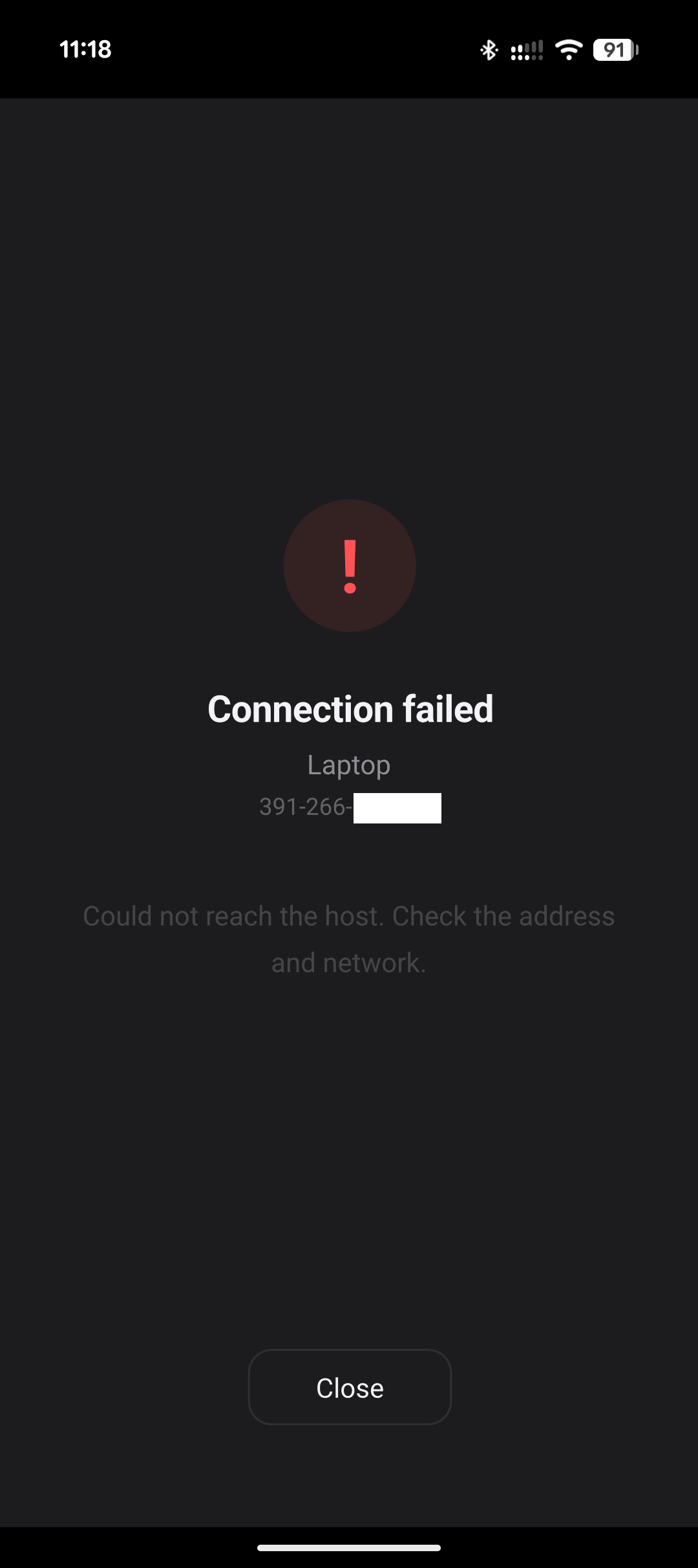

When trying to connect, the message extremely quickly changes to Connection Failed "Could not reach the host. Check the address and network."

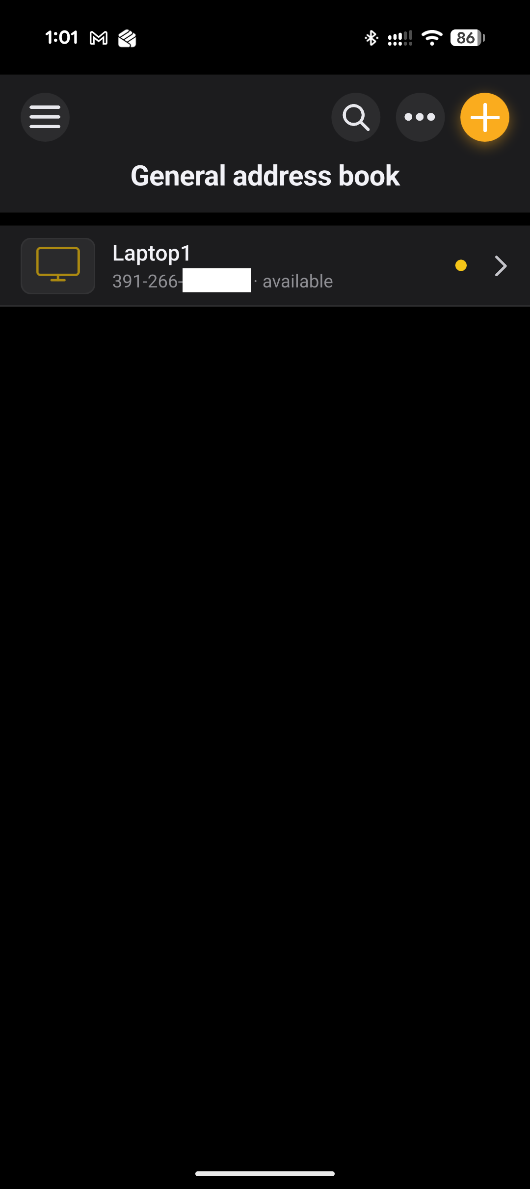

I am using a synced address book. To test, I created new connections with my self-hosted IP and my self-hosted DNS name in the apps general address book. The app is able to reach the self-hosted server, log in and sync the address book without any issues. The host shows as "available".

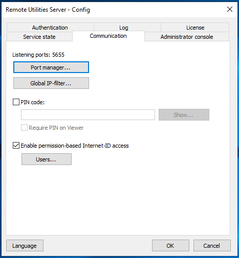

First thing to check is the server side. In Admin Console go to File -> Server configuration -> Communication tab. Check the communication port there (5655 by default). It must be the same port you entered for the server in the mobile Viewer.
On the same tab, make sure PIN code is off, or at least that "Require PIN on Viewer" is off. The mobile Viewer currently can't supply a PIN code for a self-hosted server, so with that option on the connection is rejected right away. PIN code support is scheduled for one of the next mobile updates.

See attached photos.
New Android app cannot connect through self-hosted server. New Android app cannot connect through self-hosted server. New Android app cannot connect through self-hosted server. New Android app cannot connect through self-hosted server.

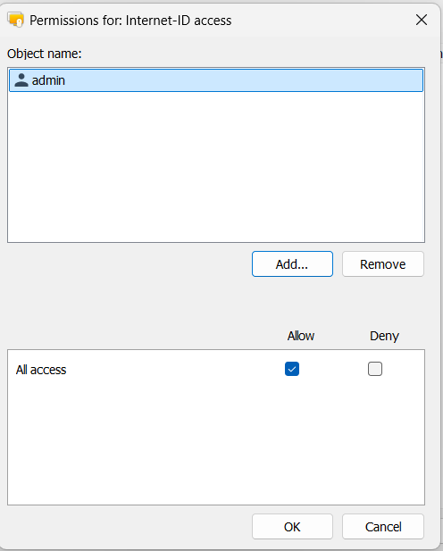

I can see that you have 'Enable permission based Internet-ID access' enabled. Please, note that selecting that checkbox makes your signing in on the self-hosted server in Viewer mandatory to be able to use the server as relay. If this checkbox is not set, the relay connectivity is 'free' meaning that it doesn't require signing in on Viewer.
If you want to use that checkbox make sure that:

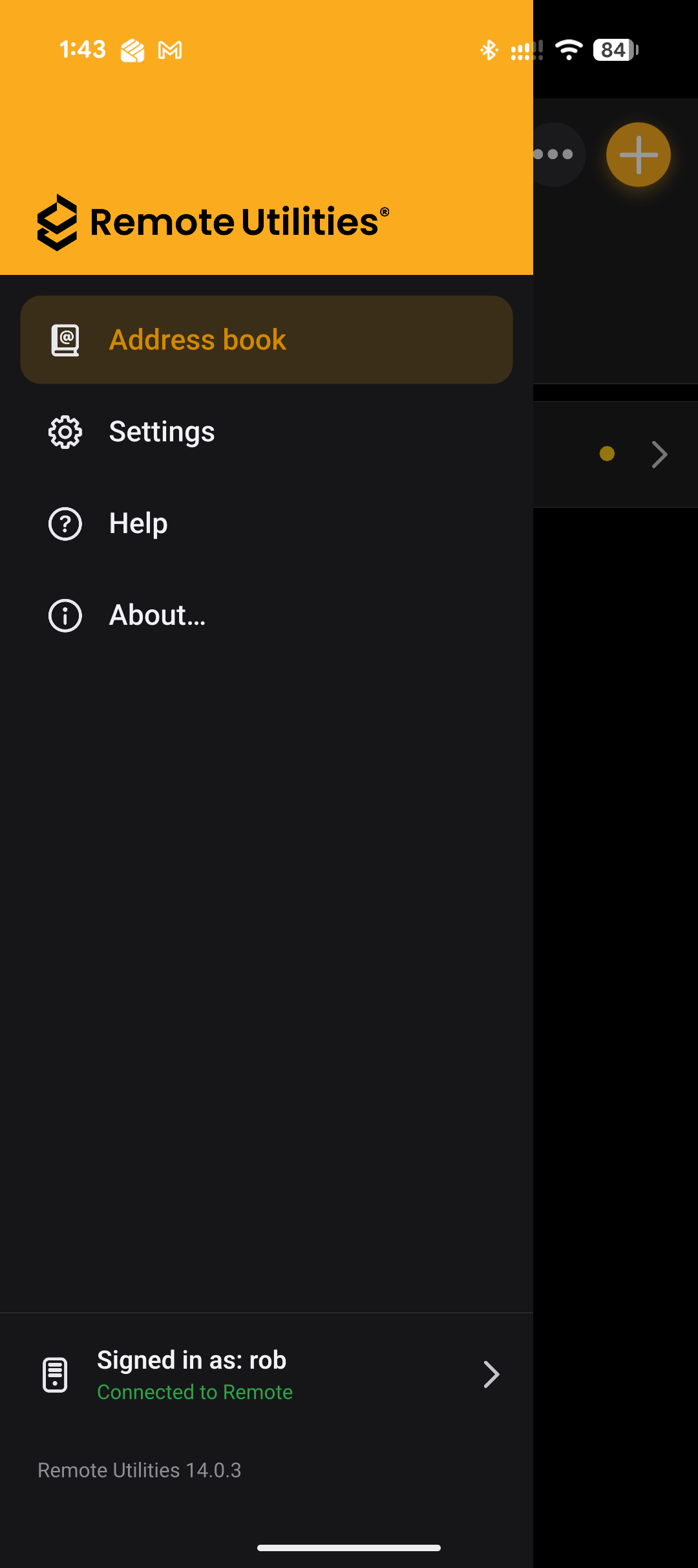

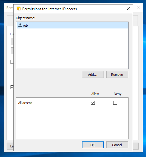

1. You sign in on the self-hosted server in the mobile Viewer.
2. The account you use for sign-in is added with the 'allow' rule under that checkbox in the 'Users...' dialog.

Discard my previous message. It is indeed a bug with connecting from the mobile Viewer when that "Enable permission based..." checkbox is enabled on the Server. Regardless of whether you are signed in on the server and your account is properly added in 'Users' - the Internet-ID connection is not established.
We will fix this bug and release an update within a few days (along with a few more minor issues fixed). Sorry for the inconvenience!
Disabling 'Enable permission based Internet-ID access' does allow me to connect with the mobile viewer through my self-hosted server. Having that enabled with permissions setup correctly and logged in to the mobile viewer as the proper user, I can not connect. See attached images.
It seems there is a mobile viewer bug or feature missing with permission based Internet-ID access on a self-hosted server. I use the same permission based Internet-ID access setup with Windows Viewer and I have no issues with it.
