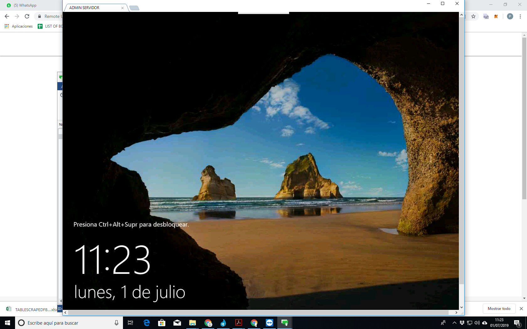

What I'd like to do is connect from my PC to the differents USERS SESSIONS I have in my WONDOWS SERVER 2016. But it seams that is not possible with Remote Utilities. I will explain why. If I use service of your competidor (teamviuwer) this service will provide me for each user session one differents ID to connect to users session. With Remote Utilities it seams that is not so... When I installed Remote Utilities in WINDOWS SERVER 2016 and I added HOST packeg, I will receive one ID for all my users sessions. But in addition to that I have another problem. When I try to connect with my WINDOWS SERVER 2016 the screen I added as file is showed, and there is no way to see DESCKTOP.
Could you please clarify if you use the Full Control mode or the RDP mode when connecting to a remote PC?
If the Full Control mode is used, then please double check if there is security software on your computer that prevents remote connection and/or input emulation typical for remote control software.
In addition, please clarify if you cannot UN-lock the PC by sending Ctrl+Alt+Del command?

1.4 Yes, I am not able to run "Ctrl+Alt+Del" command. When I run it what I am doing is to run this command to my PC and not to the PC I want connect to. Please, let me know how bypass this problem.

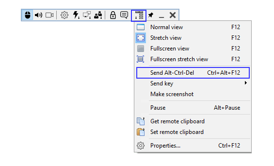

Could you please clarify if you tried sending Ctrl + Alt + Del combination to a remote PC using a special toolbar button in the Full Control mode?
Compatibility with WINDOWS SERVER 2016 - 02 Jul 2019 10:28:01
If it doesn't work, please try referring to this Knowledge Base article and see if the issue persists: https://www.remoteutilities.com/support/kb/ctrl-alt-del-is-not-sent-to-the-remote-pc/

QUESTION 1: About "Control+ALT+DEL" has been resolved. Thanks.
