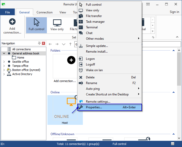

Hello Joel,
I'm glad to hear you've already figured out the issue! In addition, please note that you can switch the view mode for the remote session beofre connecting to the remote Host. This can be done in the Connection Properties window -> Mode tab. In order to open the Connection Properties, please right click on a connection entry in your address book and select Connection properties:
Change resolution of viewer to match QHD monitor high resolution - 21 Sep 2020 05:18:49
In addition, you can also switch the view mode for all the newly added connections. This can be done in the Default Connection Properties window, on the same Mode tab.
