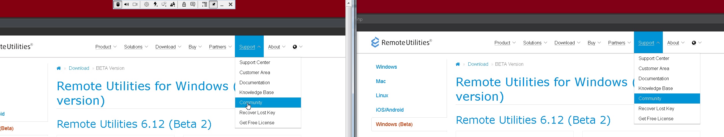

I uploaded a dual screen shot (viewer on left, host on right) showing the discrepancy between the two screens. You can see the pointer on the left, but it's missing on the right (though the drop-down menu selection is clearly shown).

Could you please confirm if the second screenshot, i.e. the Host screen where the cursor is invisible, is what you see on the remote screen using the 3rd party software (during the active remote session) and not on the actual physical remote screen? If this is the case, then this might be caused by some specifications of the 3rd party software.
In addition, please note that the cursor is always visible on the physical screen of the remote machine and follows the movement of your local cursor on the Viewer's side.

Yes the screenshot is what I saw connecting to both machines remotely using [censored]. I experienced the same issue when the viewer was my local machine, but I was still looking at the host through [censored].

Of course, I understand the situation. However, I've checked on the issue with our developers - they confirmed that it's most likely that the cursor is not displayed this way on the 3rd party software's side. We recommend that you also refer to the corresponding software's support service as according to our Support Policy we cannot assist in resolving issues with third-party software.
