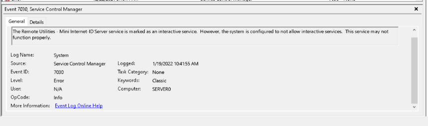

I was just looking at the server logs in Program Files (X86)\Remote Utilities - Server\Logs and there is an access violation in module InternetIDService.exe
If you think this might be relevant I can share the log.

Yes, please send us the log file to support@remoteutilities.com.If you think this might be relevant I can share the log.
