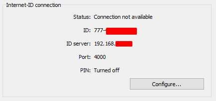

Hello Alexey,
Please double-check if the Server is visible from the outside at the port 4000. In order to do so please navigate to this page, input the Server's port number and select Check Port. If everything was configured properly and Server is visible at this specific port the form will return Success as the result.

Hello Alexey,
Could you please also let us know if you've tried restarting the RU Server or the server machine after adding the port 4000 (or any other custom port value) to the Communication ports list? If no then please try adding the custom port value to the Communication ports list once again and then restarting the RU Server (please see Configuration -> Service state tab) or the server machine itself and see if this helps to resolve the issue.

restarted it. it didn't help.
Hello Alexey,
In this case could you please provide us the RU Server log files as well as Host log files for examination? You can send the log files to support@remoteutilities.com.

I sent the logs.They are almost empty. but after looking at the logs.
I saw that when restarting the server, it does not listen to other ports.
although the port is specified
13-44-17 29-09-2021 T: Server starting. Version: 3.0.1.0 (3010)
13-44-17 29-09-2021 T: Listen 5655 port.
13-44-17 29-09-2021 T: Server started.

the question is removed.
I found out what the problem was.
If you do not close the config, it does not update the parameters.
And restarting from the config does not update these parameters either.
It was necessary to make changes, completely close the config console. and restart the server.
I feel stupid)

Sep 29, 2021 5:24:42 pm EDT
and if you restart the server without closing the config, it will reset everything to the previous values.
