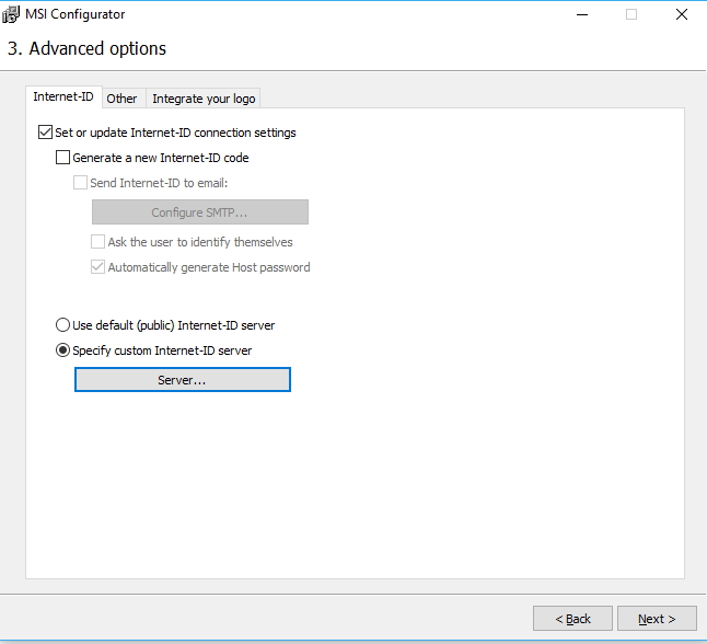

I built a custom Agent package with MSI Configurator and I don't use public RU server, but the one I installed  on my network (the latest version).
So - I do this in step 3:  Agent Upgrade changes Internet ID - 14 May 2019 09:29:52
but it always generates a new Internet ID, when I first start the new version of the Agent.

Thank you for your clarifying.
Please try downloading and running a vanilla Agent - this way the settings from your custom Agent will be picked up when running a newly downloaded vanilla Agent.
If you build a custom Agent using the MSI Configurator, your custom Agent settings will overwrite all the traces of the previous Agent.
The vanilla Agent is available for download here.
