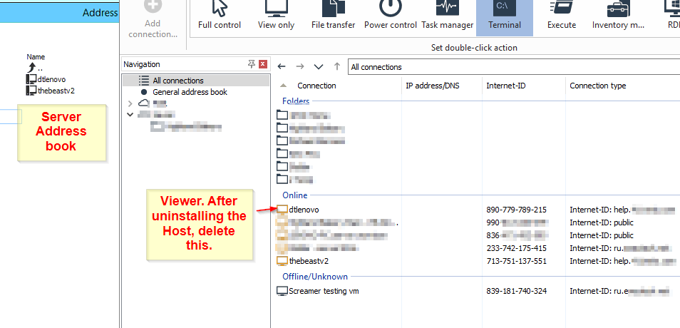

Bug: Deleting client using viewer not syncing to RU local Server
RU Server: v2.7.6.0 [2760]
RU Viewer: v6.10.5.0
Testing sync status, renaming the name of the client in viewer shows the rename in the server address book manager verifying sync is working.
Deleting a client in the Viewer, client is left in the Address book manager in the local server.

Hello David,
Unfortunately, we couldn't reproduce the issue. Deleting a connection in the Viewer also deletes it in the Server Address book manager.
Please clarify if by the client you mean a connection in the address book.

Yes sorry by client I meant Host in the RU context.

Only way to delete the item from the (sync'd to server) address book is using the servers Address book manager.
