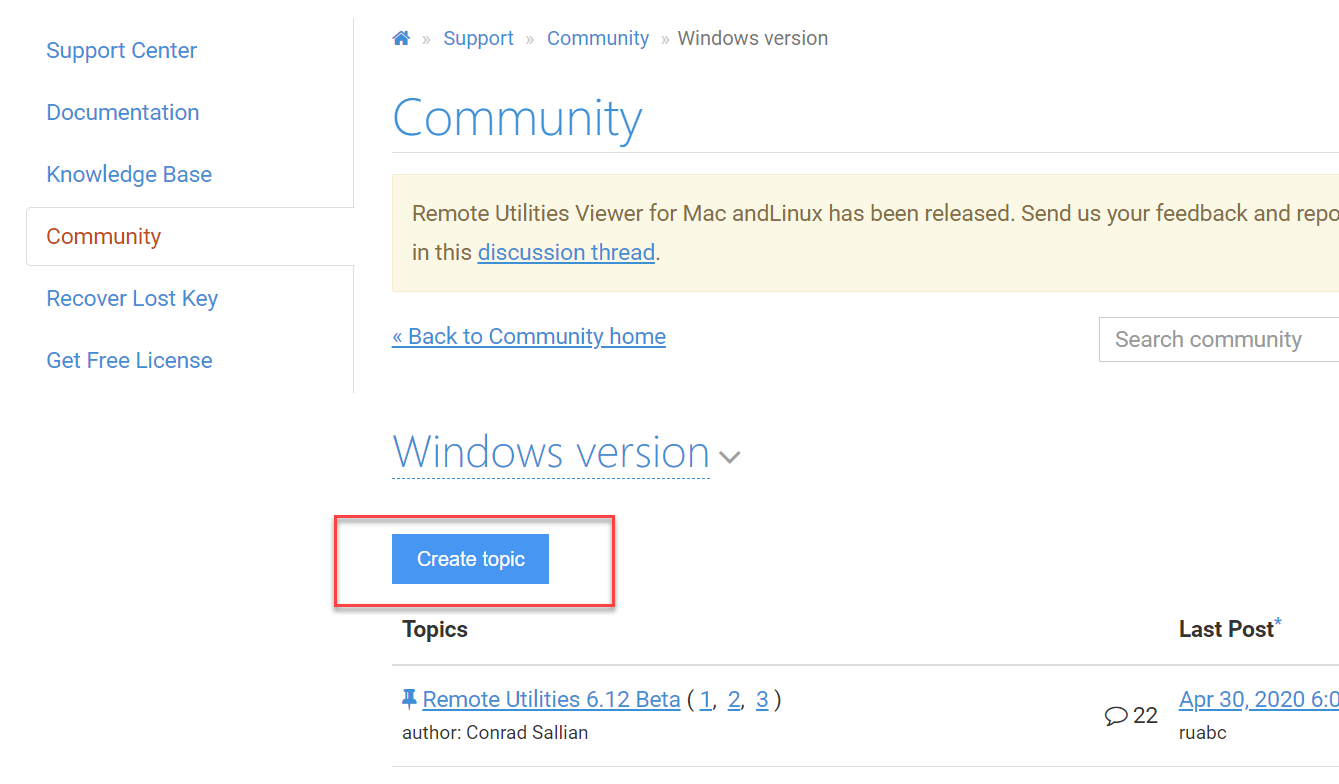

You should be able to create a new topic on a category (sub-forum) page. For example, here is a screenshot from the "Windows version" sub-forum main page:
If you cannot locate the button please let me know.
I'm glad to see that you figured out the issue. Yes, network connectivity and DNS setup may play a significant role so it takes trial and error to find the root cause.
Alan Godfrey,
May 05, 2020 8:16:57 am EDT
I would never have found it... Thank you.
