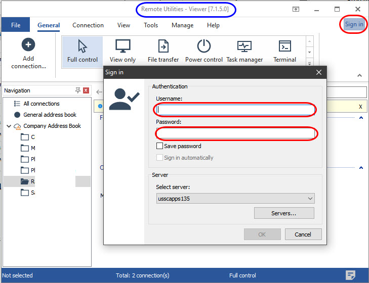

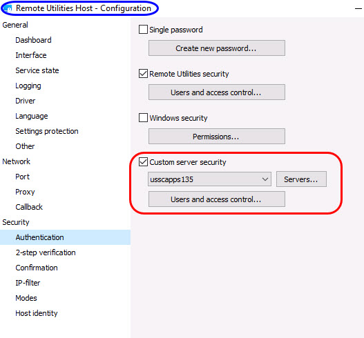

Carl Thompson,
User (Posts: 10)
Aug 24, 2022 9:07:55 pm EDT
Hi Pauline,
I believe you are talked about using active directory in the Host configuration.
I am asking about using Active Directory (AD) for the RU Server User logon name in the Address Book Manager.
The user's AD password would automatically be used instead of setting a static password.
Then when the user needs to sign in to the RU Server in their viewer they would use their AD credentials for Username and Password.
My RU Host would be configured to use the Custom server security.
The host would communicate with the RU Server though a opening in the VPN firewall and allow/control the appropriate access to the user.
Hello Carl,
Unfortunately, this scenario is not possible to achieve yet in the same way you've described - for now it's only possible to set it up as authentication in the Host Settings.
However, please also note that we've introduced new AD integration with RU Server starting version 7 of Remote Utilities if you're not using it yet. You can read more about it in this blog post.
