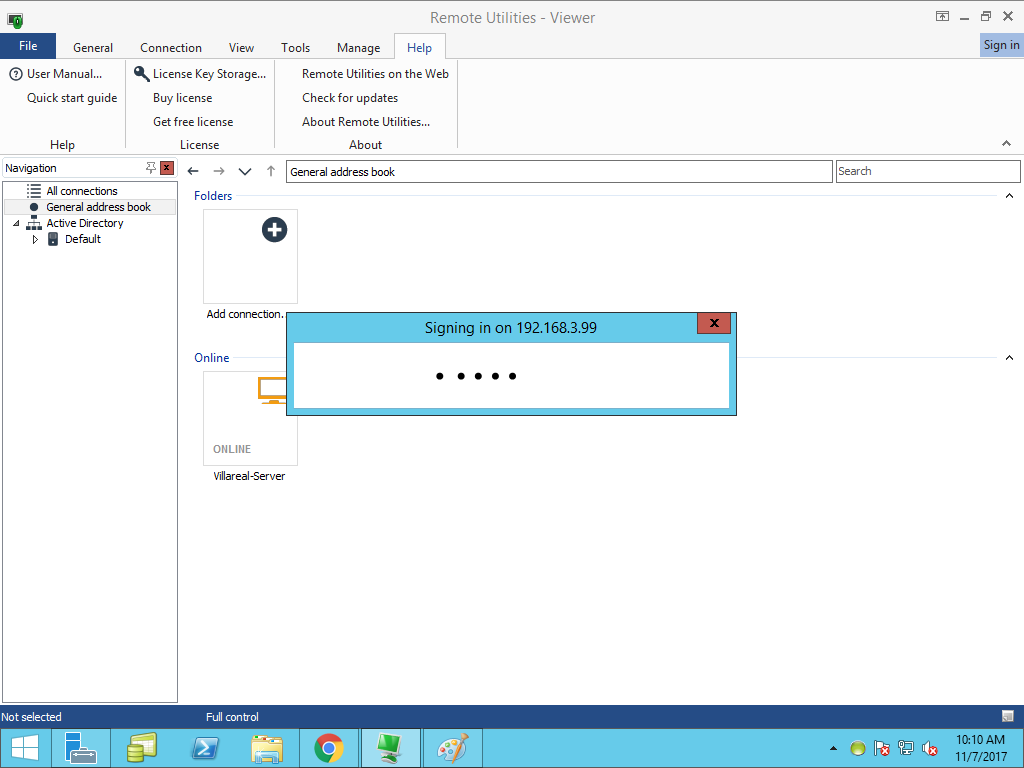

Hello everyone, last week i started to use RU in our premesis, so far this is what I been able to do.
1- Installed RU Server for relay ID server
2- Created MSI package and deploy to our computers, configured with self hosted server
3- Auto register to address book the computers in the Self hosted RU server.
4- Created user and address book and assign security for the Self Hosted server address book.
Im able to access the computers inside the network and outside the network.
what I can't do is to connect the viewer to self hosted server. I just cant login. even with a viewer inside the same network using the local ip address of the server, it just dont connect. I enter the user name and password created in the Self Hosted and the viewer just says signing on to "192.168.3.99" and then goes away and nothing, thats all i get.
I want to be able to login so i can use Sync Address Books.

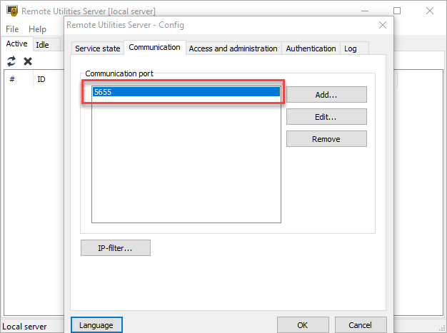

Make sure that the port specified in Viewer's server manage (Manage tab -> Server manager -> your server's properties) is the same as the communication port specified in the configuration dialog on the server side. See the attached screenshots.
Also, make sure that this port is allowed on the server machine in the firewall settings (inbound TCP port).

Thanks for your fast response.
Im sorry to inform that i have triple check the ports and they do match , im using the default ports 5655. Windows Firewall is turn OFF for all profiles, and theres no other firewall running in the machine.
any other advice?
