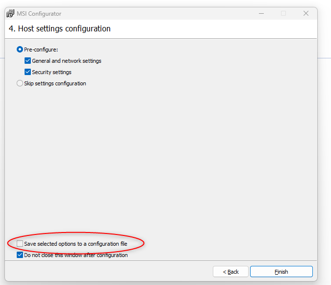

2. when saving the configuration, checkbox save selected options to a configuration file is triggered before configuration of the actual utility. Mybe this should just be a button to save after download. The configuration option doesn't popup until you click download. See pictures rm2, and rm3

That checkbox only sets where the file goes. The settings themselves, including the Host settings from step 4 if you set them, are written into the file once the configuration is done. We see your point that a button after the download would be clearer, and we've noted it.when saving the configuration, checkbox save selected options to a configuration file is triggered before configuration of the actual utility.
