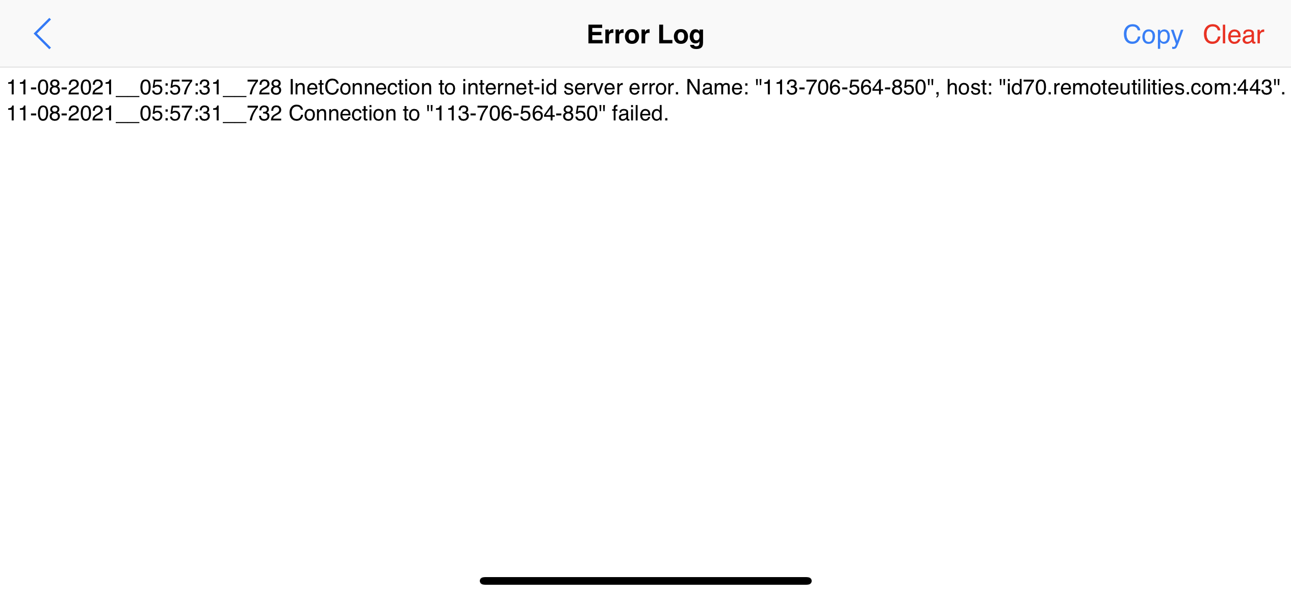

Having a problem with iphone app connecting to host computer- Windows XP.
Wi-Fi works ok with the connection i.e computer to computer but not 3G or 4G.
Loaded Remote Utilities on a mates Android phone and it works.
Checked heaps of settings in iphone, used the troubleshooting and checked port 5650 etc, tearing hair out over the last few days.
Error shows
Error shows
Hello Des,
I've noticed on the screenshot that you're connecting to your Host using Internet-ID connection. Please note that for Internet-ID connection ports that are required to be opened for the connection to work are slightly different - it's Outbound TCP ports 5655/443. For more information on ports used by Remote Utilities please see this page. Please make sure that at least one of the required ports is opened and not used by other software.
In addition, please try referring to this troubleshooting guide and see if any of the solutions help to resolve the issue.
