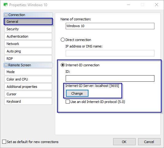

1) Your custom server's address is specified in the Host settings -> Internet-ID settings and your settings look similar to the screenshot below:
2) The custom server is specified in Viewer, in the connection properties for this specific Host:
