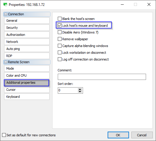

Also quick question. Is there a way to lock the host input (mouse/keyboard) without blanking the screen?? Please let me know. Thanks!!

Hello Ricardo,

Of course. To lock the Host's input, open the Connection properties menu and navigate to the tab Additional properties. Tick the Lock host's mouse and keyboard checkbox:Is there a way to lock the host input (mouse/keyboard) without blanking the screen??
You can also lock the Host's input while the connection to the remote machine is active. Select Connection properties icon on the toolbar and navigate to the Advanced tab. Select the required checkbox:
