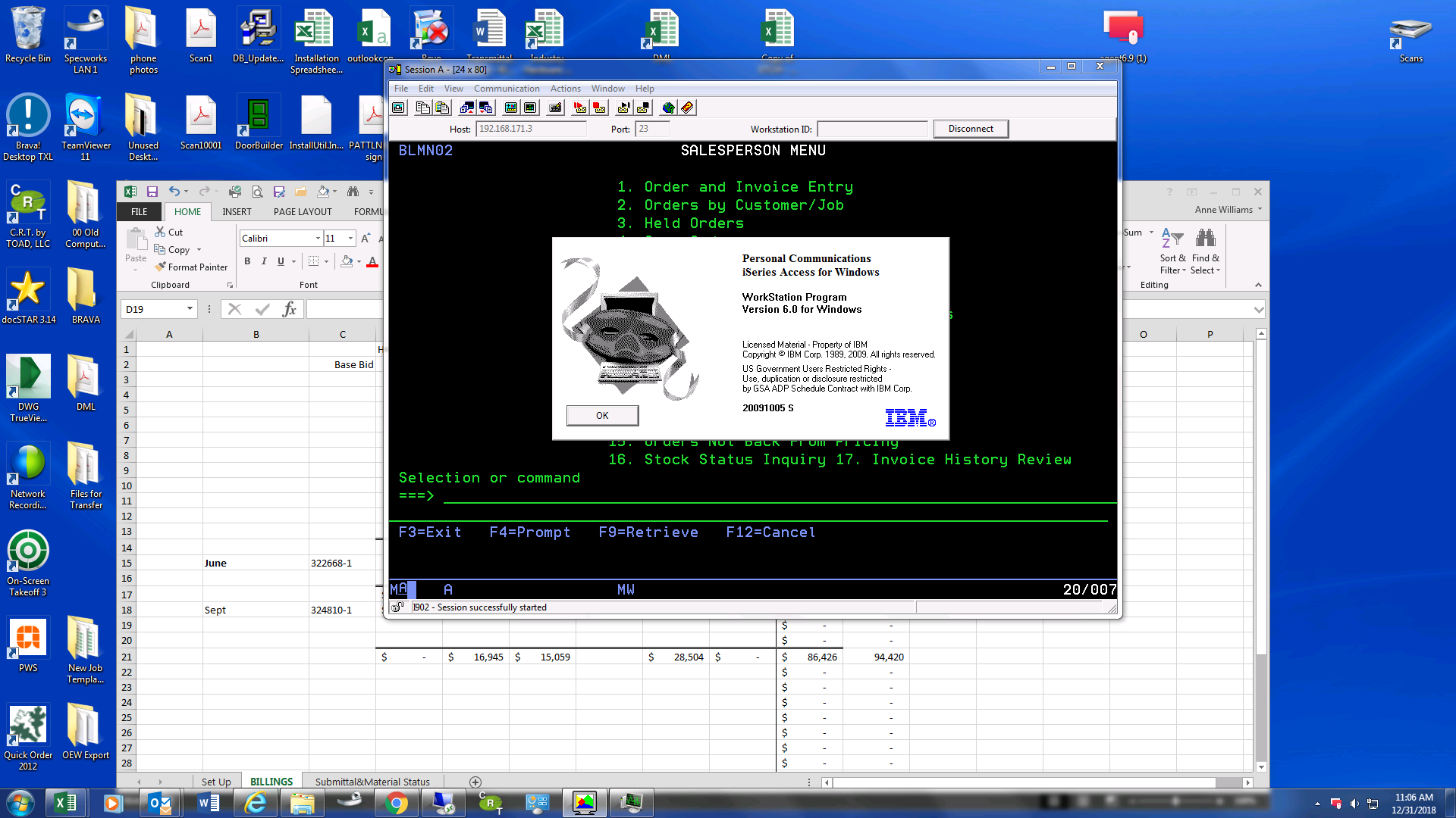

In addition to other key combinations not working after upgrade to version 6.10.2.0 (details listed in posts by others) I have a IBM VT emulator program, Personal Communications, that is not recognizing any text entered through the remote keyboard. The function keys work, but none of the letters or numbers. I did not have this issue prior to upgrade. A screen shot of the program details is attached. Let me know if you need any other details.

Hello Anne,
You are right, it's a different problem. This problem is caused by our migration to another (more modern) key input mechanism.
However, it seems that we should also keep the option to switch to older (previously used) key input/transfer mechanism just for such occasions. Some older applications as in this case may experience problems with accepting key input the new way.
So in the upcoming hotfix we'll add an option to switch to legacy key input so you will be able to enable that option in Viewer connection properties for that specific machine.
Sorry for any inconvenience.
