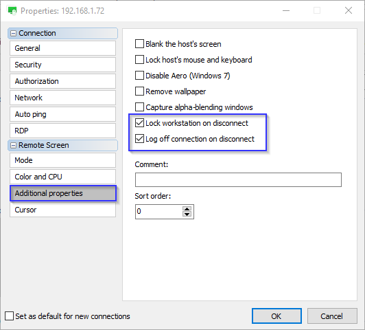

is there a way to set the host to automatically stop after a period of inactivity?
Hello David,
Unfortunately, there is no option to stop the Host on timeout, but we have a similar feature to log off the connection on timeout in our wish list. We plan to release it in our upcoming updates in the nearest future.
Although there are two other similar options - to lock remote workstation or log off the connection upon terminating a remote session.
In the main Viewer window right-click connection properties, navigate to the tab Additional properties and enable the Lock workstation on disconnect option or the Log off connection on disconnect option.
