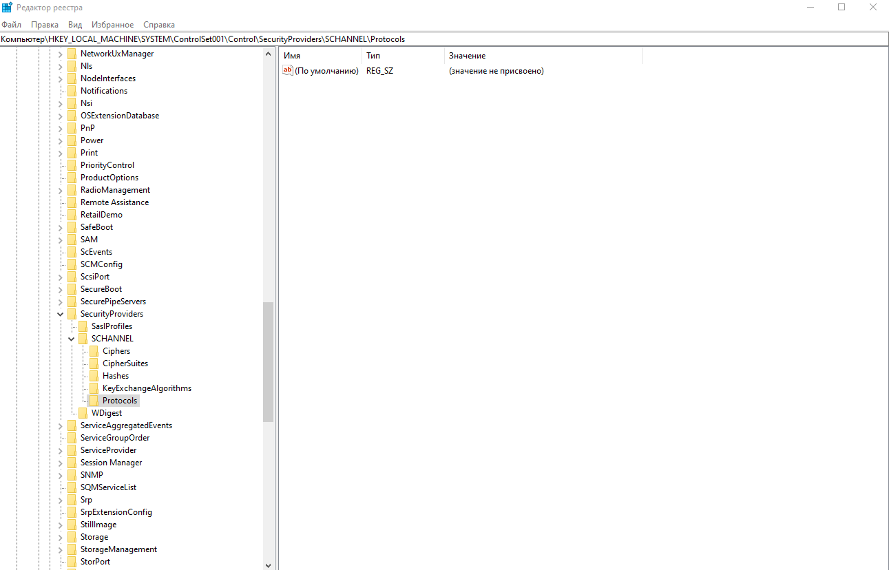

hello everyone, I have a problem when I make a new MSI Configurator, none of my mail works, neither mail outlook nor gmail, etc.. when I try to send a test letter, I have already tried everything, what should I do ? I tried to ignore sending a test letter, set the configurator for myself, but no letters came to the mail. Help.

In this case, the issue might be caused by disabled TLS protocols on your machine. Please try downloading the EasyFix wizard tool from this page, then run it and follow the steps provided by the wizard.
If the EasyFix doesn't help, please also try other solutions listed on this page that can help you to install/update TLS 1.2 on your machine.
